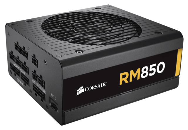

If you change the screen size of this file in XnView 2.39 (latest version), the background immediately changes from transparent to black. Is this a bug?
EDIT: added original file:

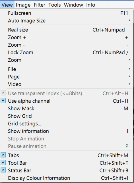

Just wanted to tell you that XnView 2.39 > Image > 32-Bit is grayed out for this example image.
Other than opening it in another imaging program which does not have this issue, can I do anything else within XnView, since 32-Bit is grayed out?

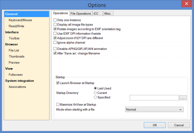

Thanks for reporting back. Could you try the following configuration?
  • Tools » Options...
    • General » Operations » Ignore alpha channel = Off
    • Read/Write » Read » PNG » Parameters » Compose image with transparency = Off
    • Read/Write » Read » PNG » Parameters » Compose image with alpha (32bits) = Off
  • Viewer mode: View
    • Use transparent index (<=8bits) or alpha channel = On
    • Use alpha channel = On
    • Show Mask = Off

As you can see, they were all already set as you instructed but this did not help.

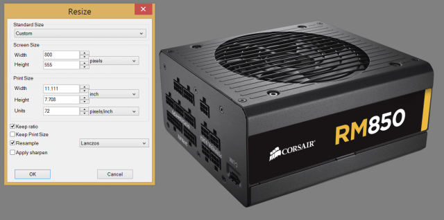

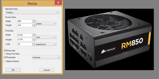

Image > Resize
Before and after screen shots:

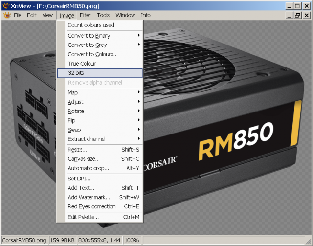

This is really weird :?
As you can see in the screenshot, Image » 32 bits isn't grayed out in my installation.
