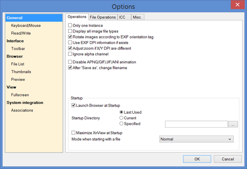

Thanks for reporting back. Could you try the following configuration?c627627 wrote:Just wanted to tell you that XnView 2.39 > Image > 32-Bit is grayed out for this example image.
- Tools » Options...
- General » Operations » Ignore alpha channel = Off

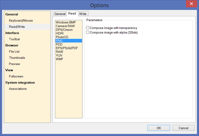

- Read/Write » Read » PNG » Parameters » Compose image with transparency = Off
- Read/Write » Read » PNG » Parameters » Compose image with alpha (32bits) = Off

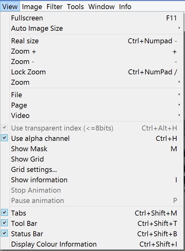

- Viewer mode: View
- Use transparent index (<=8bits) or alpha channel = On
- Use alpha channel = On
- Show Mask = Off

As you can see, they were all already set as you instructed but this did not help.

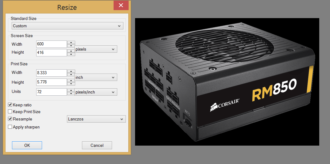

c627627
- Posts: 57
- Joined: Fri Jun 26, 2009 5:00 am
Re: If you change the screen size, the background color chan

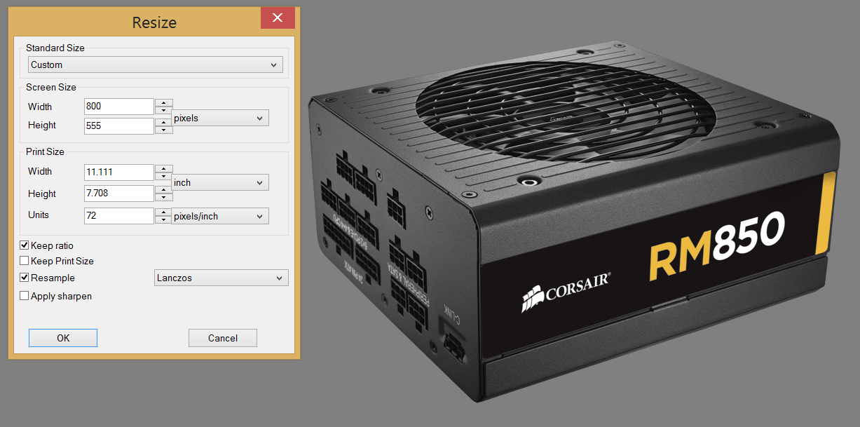

Image > Resize
Before and after screen shots:
- Forum Librarian
- Posts: 6552
- Location: Ref Desk

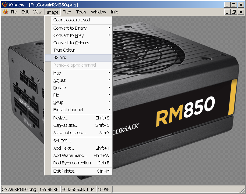

This is really weird
As you can see in the screenshot, Image » 32 bits isn't grayed out in my installation.

Resolved.
1. Go to original page:
http://www.corsair.com/en-us/rm-series- ... wer-supply
2. Right click on the power supply picture directly and save it to your computer.
3. Open it in XnView and before doing anything, go to XnView > Image > 32-Bits
Now it can be resized without a problem.
