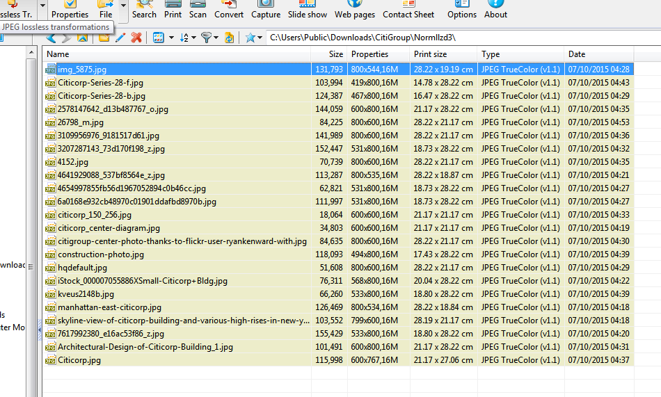

For quite a while now, XnView has failed to properly resize all selected photos in batch operations. It's now worth documenting, I believe.
Upon selecting a set of random photos, images of all shapes and sizes, I have, today, set a batch process running that I hoped would output resized images with at least one side 800 pixels long.
The output set appears here: https://goo.gl/photos/JrTB2eeFiUjkFnnQ9
or here:
Resized Set
Resized Set
You can see, at about the centre, two images are too small (600x600), and the one at the bottom also loses a dimension a little.
Those first two originated as square.
What do you think is happening?
Thx.
(XnV currently 2.33)

THE contents of the .xps batch process file are:
resize( 1 lanczos 800 600 0 1 0 )
settings( 0 0 1 1 1 0 0 )
output_path( C:\Users\Public\Downloads\CitiGroup\Normllzd3 )
output( jpeg 80 0 1 2 2 0 1 1 1 0 1 )

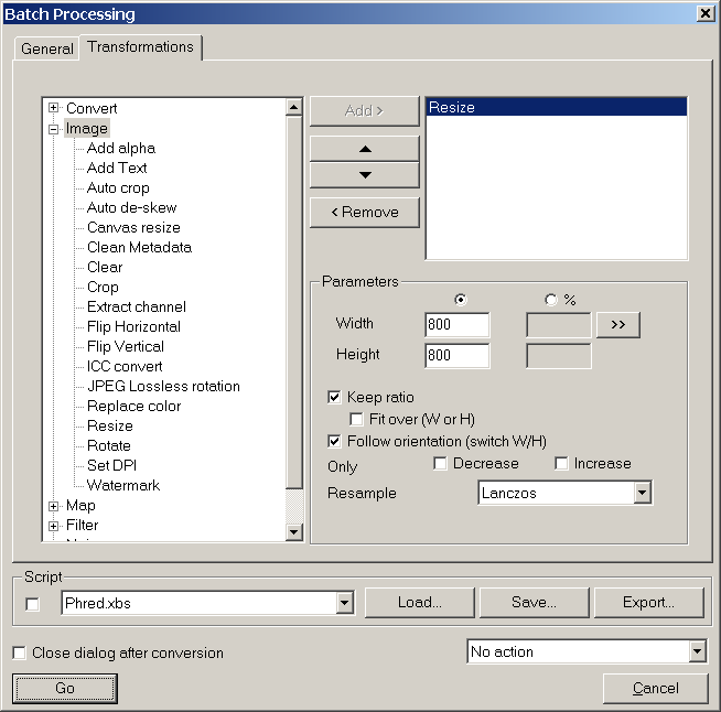

Could you please give the following script a try?
resize( 1 lanczos 800 800 0 1 0 )
I believe you have to change the value for Height to 800 to achieve the desired results.

Yes, XnTriq, that seems to have solved the matter - oddly enough.
I stayed away from that technique because it implied that the output would be square. 800x800 but with 'Keep ratio'. Which would be subordinate?
I suspect I'll just have to put it down to the dialect of English called 'French'. :?
Quite what 'Fit over (W or H)' and 'Follow orientation (switch W/H)' really mean, I don't know. The Help is silent (on this and many other aspects).
'Follow orientation'? If something's in portrait mode but the parameters are saying change to 1000W & 500H, maintain orientation/ratio, and resize, notwithstanding, to 500W x 1000H? Sort-of makes sense.
800 x 800? Maintain orientation/ratio, and resize at least one side(?) to 800? :|
But 'Fit over'?? I'm thinking of a fitted bed-sheet going on a mattress the wrong way, but then....?
Thanks, Immediate problem solved, more or less.

Phred wrote:'Follow orientation'? If something's in portrait mode but the parameters are saying change to 1000W & 500H, maintain orientation/ratio, and resize, notwithstanding, to 500W x 1000H? Sort-of makes sense.
At least that's my interpretation of this option.

No. The setting is only to inverse width/height for resize to follow picture orientation
Posts: 6523
Re: Resize (Batch) Inconsistent in Results
xnview wrote:The setting is only to inverse width/height for resize to follow picture orientation
… which makes it…
PBY ([url=http://newsgroup.xnview.com/viewtopic.php?p=52814#p52814]Resize in Batch conversion[/url]) wrote:[…] possible to resize the LONG SIDE to a specific size. That's great with portrait/landscape photos.
IOW: Follow orientation (switch W/H) is for “orientation-dependent resizing”.
