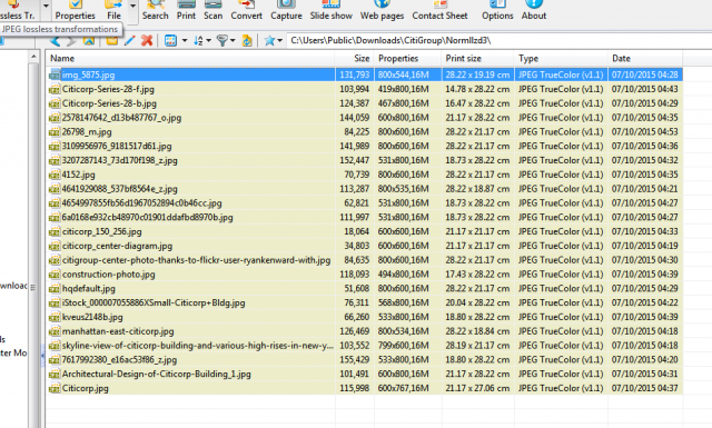

For quite a while now, XnView has failed to properly resize all selected photos in batch operations. It's now worth documenting, I believe.
Upon selecting a set of random photos, images of all shapes and sizes, I have, today, set a batch process running that I hoped would output resized images with at least one side 800 pixels long.
The output set appears here: https://goo.gl/photos/JrTB2eeFiUjkFnnQ9
or here:
You can see, at about the centre, two images are too small (600x600), and the one at the bottom also loses a dimension a little.
Those first two originated as square.
What do you think is happening?
Thx.
(XnV currently 2.33)
(FWIW, I just cannot bring myself to change over to XnViewMP because it has lost the single greatest feature of XnView Classic: the Ctrl-C ability to copy an image; not a reference to an image, not a shortcut, an IMAGE. :shock: )
(FWIW2, the photos are about CitiGroup's NYC skyscraper that almost fell over. IKYN.)
THE contents of the .xps batch process file are:
resize( 1 lanczos 800 600 0 1 0 )
settings( 0 0 1 1 1 0 0 )
output_path( C:\Users\Public\Downloads\CitiGroup\Normllzd3 )
output( jpeg 80 0 1 2 2 0 1 1 1 0 1 )

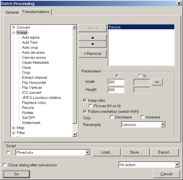

Posts: 6563
Re: Resize (Batch) Inconsistent in Results
Hi Phred (-:
Could you please give the following script a try?
resize( 1 lanczos 800 800 0 1 0 )
I believe you have to change the value for Height to 800 to achieve the desired results.
Phred
Posts: 45
Joined: Fri Nov 06, 2009 3:48 pm
Location: SEAu
Post by Phred »
Yes, XnTriq, that seems to have solved the matter - oddly enough.
I stayed away from that technique because it implied that the output would be square. 800x800 but with 'Keep ratio'. Which would be subordinate?
I suspect I'll just have to put it down to the dialect of English called 'French'. :?
Quite what 'Fit over (W or H)' and 'Follow orientation (switch W/H)' really mean, I don't know. The Help is silent (on this and many other aspects).
'Follow orientation'? If something's in portrait mode but the parameters are saying change to 1000W & 500H, maintain orientation/ratio, and resize, notwithstanding, to 500W x 1000H? Sort-of makes sense.
800 x 800? Maintain orientation/ratio, and resize at least one side(?) to 800? :|
But 'Fit over'?? I'm thinking of a fitted bed-sheet going on a mattress the wrong way, but then....?
Thanks, Immediate problem solved, more or less.
(As far as XnViewMP losing Ctrl+C, image copy, goes, I find I can't search for Ctrl+C, Ctrl-C, Control+C etc in this forum..)
Phred wrote:'Follow orientation'? If something's in portrait mode but the parameters are saying change to 1000W & 500H, maintain orientation/ratio, and resize, notwithstanding, to 500W x 1000H? Sort-of makes sense.
At least that's my interpretation of this option.
alexandrei ([url=http://newsgroup.xnview.com/viewtopic.php?t=12403&p=47673#p47673]resize plugin: how to fit largest side?[/url]) wrote:
xnview wrote:So use W:1024/H:1024
JohnFredC wrote:I've been confused about this too... perhaps some modification to the interface would make it clearer. Different wording, or a mouseover with more instructions?
yes, 1024/1024 makes sense, but it's not like it comes into your mind when you want to resize based on just one side :)
This should be documented, or at least mentioned on the "how to" topic on the forum!
Posts: 6563
About.com ([url=http://graphicssoft.about.com/od/xnview/qt/batchresize.htm]How to Resize a Batch of Images with XnView[/url]) wrote:
  • Fit Over - Checking the "Fit over" box will cause XnView to change the smallest size to what you have specified, and the other dimension will be whatever it needs to be to maintain the ratio. That means it may be larger than your specified dimensions in one direction. Use this when only the image width OR height matters.
  • Follow orientation - This option is undocumented, and I have not been able to make sense of it. Recommendation is to leave default, unless you get unexpected rotation, and then try reversing the option.
  • Only Decrease/Increase - With decrease checked, images smaller than your specified dimensions will not be made larger. With increase checked, images larger than your specified dimensions will not be made smaller.
  • Resample - Specify the interpolation algorithm used for adding and deleting pixels. Lanczos is the default and gives high quality results. Recommendation is to leave Lanczos unless you have a reason for using another method.
  • Script - This is useful when you often need to use the same settings for a batch operation. Check the box and press "save" to keep your settings in a file that you can re-load later. To re-load a previously saved settings file, choose it from the menu, or press "Load" to open a script file from a folder. The "Export" button allows you to save it as a Windows script (.bat or .cmd file).

Phred wrote:I'm settling in to the new meme determining my understanding of resizing, Hs and Ws, and fits.
You've made an important point, though. XnView's batch resizing is too powerful to have undocumented or misunderstood options. I think we should consider renaming Fit over (W or H). “Aspect Fit” / “Aspect Fill” / “Scale to Fill” seems to be the most commonly used terminology (UIImageView Scaling Explained Visually).
Posts: 6563
foxyshadis ([url=http://newsgroup.xnview.com/viewtopic.php?p=53106&hilit=follow+orientation+landscape+portrait#p53106]Resize in Batch conversion[/url]) wrote:Follow orientation is an exif switch that will automatically rotate the image according to exif metadata.
:? Can you confirm this, Pierre? Don't we have Rotate images according to EXIF orientation tag (Tools » Options... » General » Operations) for that?
Posts: 47726
No. The setting is only to inverse width/height for resize to follow picture orientation
Posts: 6563
xnview wrote:The setting is only to inverse width/height for resize to follow picture orientation
… which makes it…
PBY ([url=http://newsgroup.xnview.com/viewtopic.php?p=52814#p52814]Resize in Batch conversion[/url]) wrote:[…] possible to resize the LONG SIDE to a specific size. That's great with portrait/landscape photos.
IOW: Follow orientation (switch W/H) is for “orientation-dependent resizing”.
