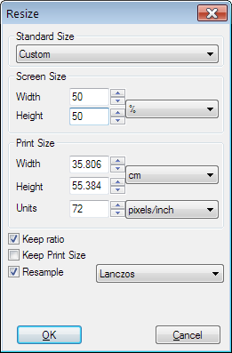

I am a member of several Forums which restrict the size of any attachments to be added. If I use my scanner to enter information, such as schematics, or hand drawn sketches, it always produces a file that exceeds the maximum allowed by the Forum.
Using XnView, how do I reduce my files which are in excess of 250KB to something smaller without losing too much detail? I am not sure which of the commands to use to accomplish my goal, do I use dimensions or pixel size? Any comments or help is appreciated.

For further reducing file size the answer might be to downsample the images and check the file size and quality obtained. You can do that using XnView's Image > Resize... :
Setting the screen size to 50% as shown will halve the pixel dimensions of the image, and selecting 'Maintain ratio'' saves time as one dimension can be changed and the other automatically adjusts. The optimum resampling method for downsampling may depend on the image.

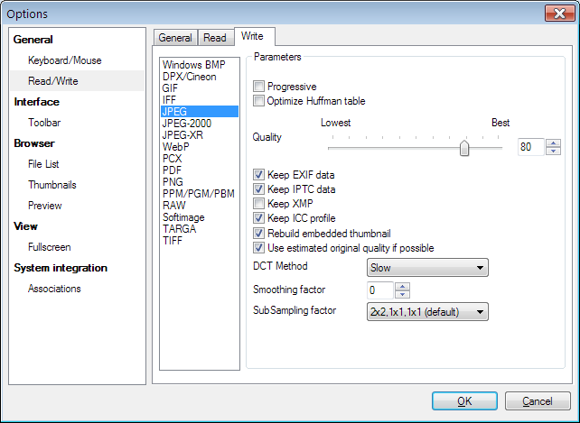

If your files are JPEGs there may be considerable scope for further compression, depending on the level of compression currently used. Open the images in XnView, then select File > Save as... , set the file type to JPEG, then click on 'Options' immediately below at bottom left.
[Use the scroll bar to the immediate right of the above image to scroll down the image if necessary.]
Then, in the right pane of the Write tab, use the slider to set the 'Quality' to a lower value, click 'Save' and then check the size and quality of the resulting image.
Whether JPG is actually the optimum file type for your images is another question if they are schematics: if they are black and white TIFF with CCITT G4 compression might be much smaller, and if they are colour but with a small number of colours, one of the PNG options might be much smaller, and both formats also provide lossless compression, unlike JPEG.
Using the above information you may well be able to avoid the need to downsample your images.
