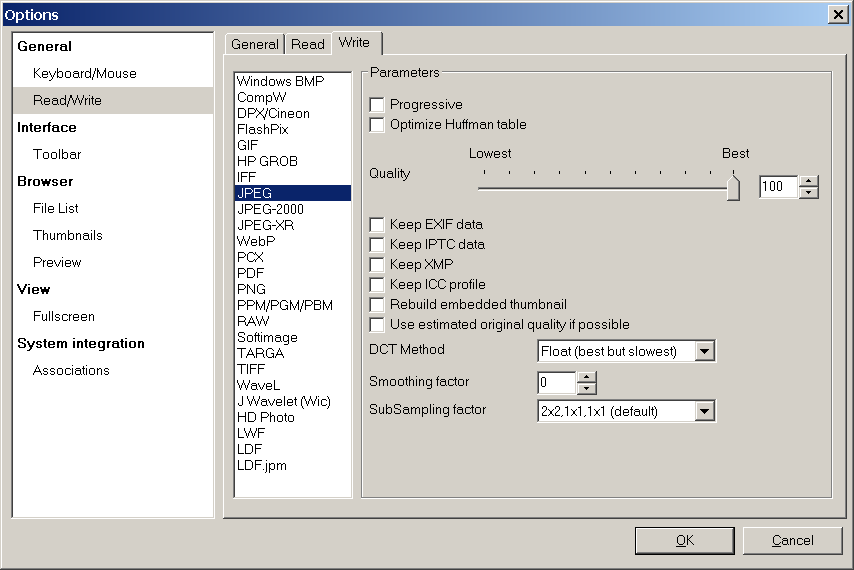

It depends. Let's say your JPEG that was previously saved without chroma subsampling i.e. 1×1,1×1,1×1 (best quality). Re-saving/re-encoding this JPEG with a SubSampling factor of 2×2,1×1,1×1 (default) inevitably introduces additional loss in quality. As mentioned before, the Use estimated original quality if possible setting only takes the (estimated) “quality factor” (1 – 100) into account.
Posts: 6519
Re: Basic understanding of "JPEG Quality"?
Original image<br />www.cambridgeincolour.com/tutorials/bit-depth.htm
Original image
Original PNG converted with XnView to JPEG (no chroma subsampling)
Conversion settings
Conversion settings
Converted JPEG resaved with XnView (default chroma subsampling)
Resave settings
Resave settings
Converted and resaved JPEGs compared with Image Comparer<br />www.softpedia.com/get/Multimedia/Graphic/Graphic-Others/Image-Comparer.shtml
The XnView file 'info' displays 'Subsampling', so in principle that could be read and an image resaved using Use estimated original quality (when possible) with the same subsampling, even if you say that is not implemented now?
But what, if an image were resaved with the same subsampling 10 times, would you expect the quality of the resulting image to be: 0.107, a substantial loss of quality?
